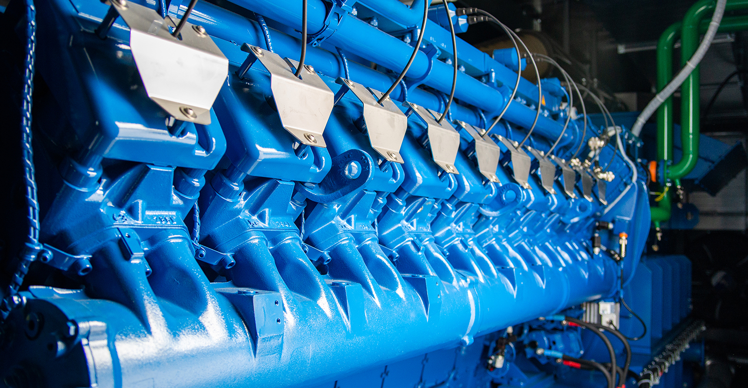

Combined Heat and Power (CHP) is electric-generating equipment installed on your site, with the added feature of being able to use the engine’s heated exhaust for productive purposes. CHP has been available for years but few foundries have been interested because utility power has been cheap and reliable.
Now, the Feds suggest using CHP because it can be the most efficient type of onsite generation. Foundries may prefer basic generation systems because they are cheaper. These are much like back-up generators that some foundries have for emergencies, but usually they are larger and are run for long periods of time. You can generate all, or part, of your electric needs. You save on the cost of your power and have greater resilience from grid outages.
The DER is installed on “your side of the electric meter,” just like your melting equipment, etc. It can be used alongside your power company service, reducing how much power you consume from them. This will reduce the cost of your electric bill and provide for some power if there is a grid outage. With enough DER you also can completely disconnect from the grid, although most foundries see some benefit to remaining connected to their utility.
You could use a variety of DER technologies to generate power, including wind and solar. But due to the high electric needs of a typical foundry, it’s likely you’ll find that generators that use natural gas for fuel are the most appropriate option. It’s all about price / performance and it depends on your cost factors and requirements.
