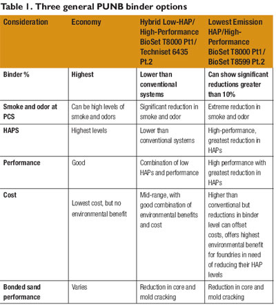

Binder — Many PUNB binders are available and produce good castings. How do you choose the most efficient? When considering a no-bake product, the overall cost should be a balance between material costs, performance, and emissions.
Conventional “economy” binders may seem to offer the lowest costs and are sufficient in many applications. However, compared to a high-performance/low-emission binder such as HAI’s new BioSet T series, the latter offers the same physical properties required at a lower binder percentage. And, the high-performance binder typically helps to reduce core or mold scrap. Despite a higher raw material price, the high-performance binder may deliver the lowest cost casting.
Hybrid binders combine economy with performance, and may improve overall costs. For example, combining BioSet T 8000 part 1 and Techniset 6435 part 2 improves core and cast properties with lower emissions and some of the cost advantage of the economy binder.
The last consideration is high-performance/low-emission binders. PUNB binders contain hazardous air pollutants (HAPs) and are a source of emissions in the casting process. BioSet T8000 part 1 and BioSet T8500 part 2 are newly formulated PUNB binders that combine high-performance characteristics with low HAPs. Low-HAP binders improve the work environment and help foundries meet emission regulations. When high-performance/low-emission binders are used, emissions are lowered through binder reduction. HAP reductions can be clearly quantified and offset potential emission fees.
Three basic PUNB binder options are highlighted in Table 1. When choosing the right binder for your foundry, consider all variables, from material cost to cleaning cost, and be sure to weigh in the environmental impact of the binder.
