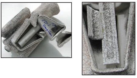

Figure 1: A seven-layer 2-G shell with deep cores. The wax pattern was removed by a flash burnout 45 minutes after the last layer was applied. The image on the left is a cutaway, showing the surface of the deep core. The image on the right is a cutaway showing the build of the deep core.

We made mechanical testing specimens using traditional and 2-G stuccos. These were tested at Minco, a fused-silica manufacturer. We premixed the 2-G stucco components. There was no dust generated when using the mixture in a fluidized bed, and the components did not separate. The 2-G mixture fluidizes well. Figure 1 shows a seven-layer 2-G shell with blind, deep cores that was built and poured in a single shift.
The shell in Fig. 1 has seven layers that were applied with 30 minutes between dips. It did not have a seal coat. The wax was burned out using a flash burner 45 minutes after the last layer was applied. The interior surface of the shell is very smooth with fingerprint-quality surface detail.
