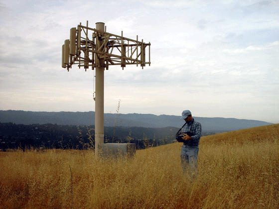

This family of analyzers helps field technicians perform verification and fault location testing to detect problems before they become costly, time-consuming system failures,” explained process engineer Sam Krull. “Their capabilities include precision return loss/VSWR, cable loss, and distance-to-fault (DTF) measurements. The RF shields are an important element in these designs, as they prevent crosstalk within the devices,” he said. Site Master Cable and Antenna Analyzers are the leading choice for installation, troubleshooting and maintenance of microwave cables and communication systems in cellular and broadcast industries, as well as in aerospace and defense fields.
