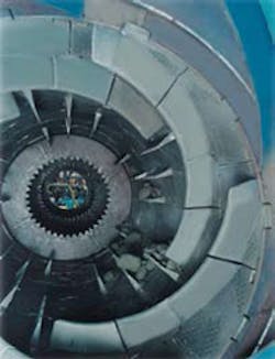

Didion International Inc.’s latest invention is the new Mark 5 Series rotary media drum, which performs shakeout, sand conditioning, double sand screening, casting cleaning, and casting cooling in one efficient step, so the foundry stays much cleaner with less airborne silica dust. Combining these processes can save a foundry $40-80/ton, and according to Didion the patented design has the industry’s lowest operating cost per ton worldwide.
Foundries get several benefits: less capital equipment purchased and space occupied; lower energy costs, maintenance time/costs, and shot consumption; fewer replacement parts; cleaner working conditions; and cleaner returns to remelt, reducing slag build-up.
The new Mark 5 streamlines production, with cooled, clean castings going directly to finishing. Return sand is blended and conditioned so temperature and moisture content are consistent, for better control at a mixer. The sand stays in the system, so the foundry is cleaner. Dust collection is efficient due to the small open area of the drum. The Mark 5 requires 75% less dust collection than a vibrating shakeout rated at the same capacity. Counterflow air eliminates fugitive emissions, protecting workers from airborne silica dust.
The Mark 5 is the only shakeout system that separates core sand from green sand and discharges each at separate points. The machines have variable-speed drives so the operator controls the action. The media bed protects nonferrous and fragile castings as it cleans and cools them. Custom linings are available for aluminum, brass, malleable gray, ductile, and steel castings. Installations include green sand, shell, no-bake, and lost foam systems.
Recent improvements in the Mark 5 Series include new interlock liners that are thicker and wider for longer life, 50% fewer seams, and contoured rifling for delicate castings, self-relieving tapered separation chambers, split pillow block endtrucks with quick-change bearing inserts, and automatic chain tensioning.
System improvements include water quenching directly after the machine to avoid long cooling conveyors, further saving equipment costs, energy, time, and space. For plants using casting baskets and stage cooling, water quenching after the rotary drum can streamline production flow and eliminate bottlenecks in the cleaning room.
