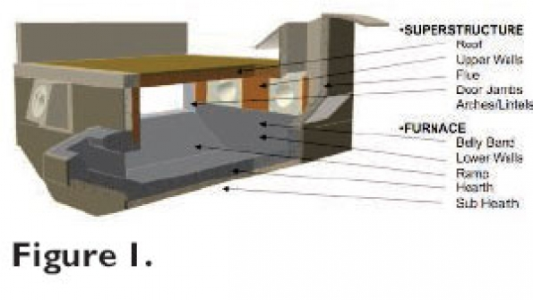

Monolithics are used to line the metal and non-metal contact regions in typical melt-hold gas fired reverbatory furnaces. Each region is subdivided, as illustrated in Fig. 1, and each has a different set of operating conditions. Therefore, a variety of refractories are required for a complete furnace lining.
Operators are melting and holding a variety of fluxing materials, so the monolithics must cope with the specific chemistry present in the furnace. In addition, different operating practices (e.g., methods and frequency of cleaning) mean that diverse physical conditions can influence different parts of the furnace.
