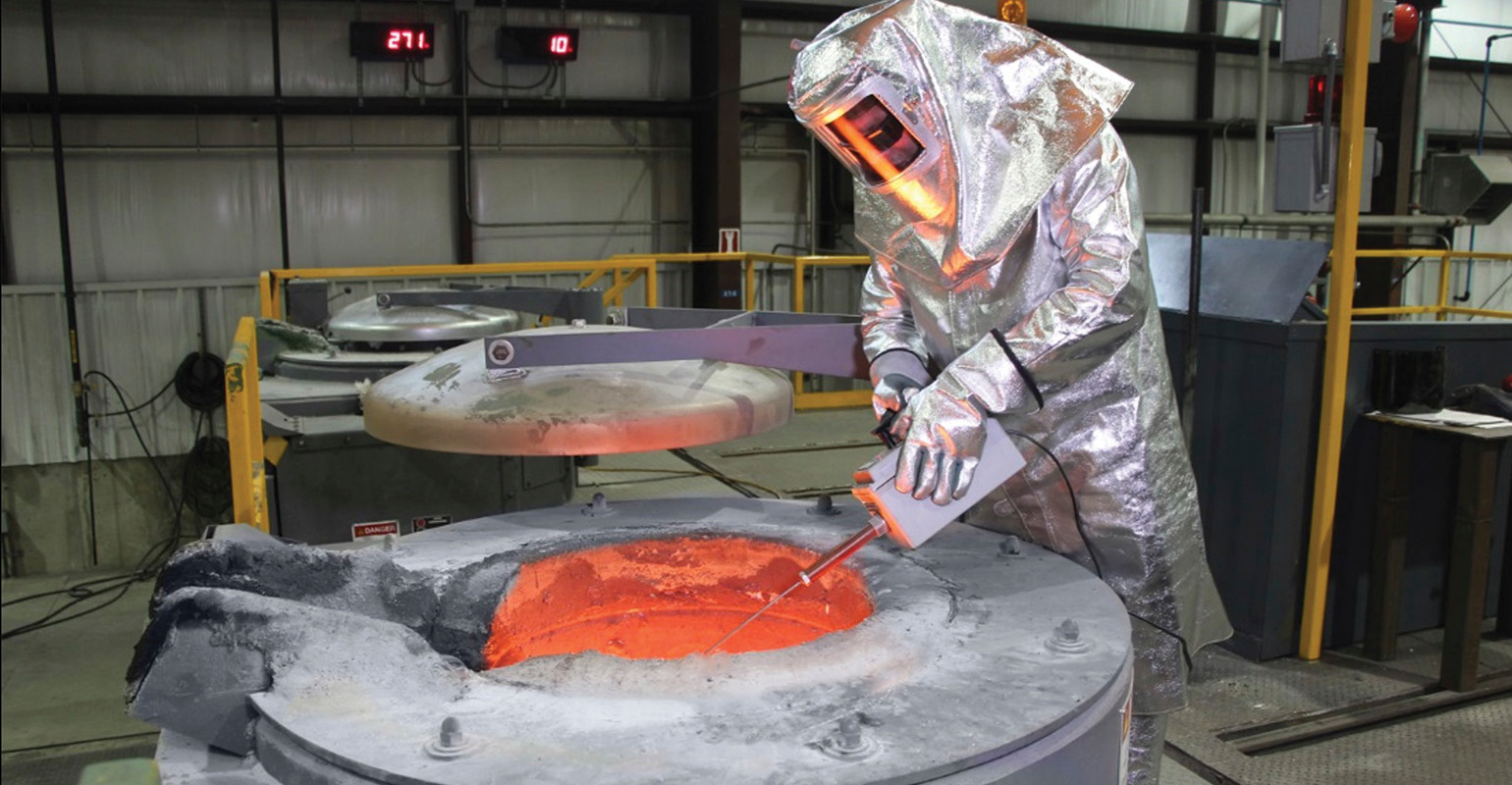

A Guide to PM for Coreless Induction Melting
Preventive maintenance is essential to maintaining productivity and system reliability for metalcasters’ induction power supply units, furnaces, and water-cooling systems.
Preventive maintenance (PM) commonly refers to the practice of regularly servicing equipment on a pre-determined schedule. Before any PM is done, regardless of which step, make sure appropriate PPE is worn and safety procedures are followed. For metalcasters operating induction melting furnaces, regular and planned maintenance is critical so that small issues do not develop into costly catastrophic failures, that the equipment performs better over its useful life. Some of the immediate advantages of preventive maintenance include:
