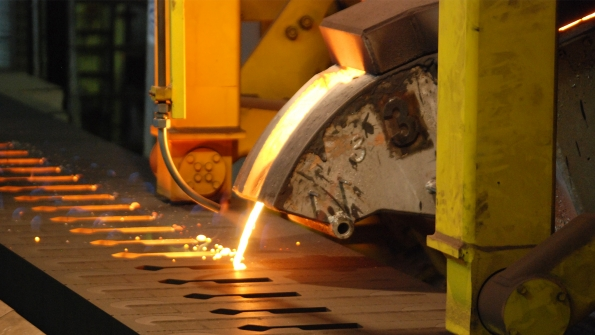

Casting a new steel alloy for piston rings at Federal-Mogul’s Burscheid, Germany, ferrous foundry.

The company’s standard production process for piston rings has been “stack casting,” multiple molds assembled in horizontal layers, which results in variable molten-metal pressure and flow velocity.  The one-piece molds also reduce the range of piston ring designs that can be cast.
Federal-Mogul said its new vertical casting process uses a special mold design that provides new opportunities for optimizing the design of the blanks and gating systems, which improves metal flow control.
Federal-Mogul’s Slow-Motion Casting Simulation technique using high-speed cameras to provide a more detailed analysis of mold filling, enabling precise optimization of the gating and feeder systems that control molten material flow.
The new process — which is installed at Federal-Mogul’s ferrous foundry in Burscheid, Germany — feeds molten metal around the complete circumference of the mold, which improves significantly the uniformity of graphite formation in the gray iron. The fully automatic molding and pouring process includes extensive monitoring and in-process documentation of all relevant parameters. The process developers claim this ensures more reproducible molten metal flow rates and more thorough mold filling, which results in more consistent piston ring quality.
