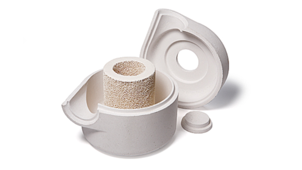

Another paper to be presented, “UDICELL - Tubular foam ceramic filters for the foundry industry,” will be presented by Ulrich Voigt, product manager Filters Europe. UDICELL filters are especially well suited for secure filtering of large quantities of liquid metal and feature a unique, value-added design. The advantages of this design include more than three times the filter area compared to a conventional plate-shaped filter of the same size; a self-supporting geometry; a minimized risk of filter breakage; a compact structure; and a quick and easy installation.
