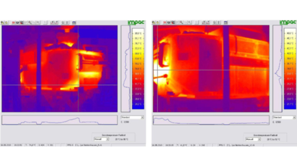

“After operating periods of up to 17 years, it has now become necessary to reline the existing systems,” explained Holger Stephan, manager of StrikoWestofen Service and Spare Parts. “Extensive measurements and thermographs allowed us to identify additional opportunities for optimizing the refractory design. In the context of a comprehensive modernization, we will reduce the energy consumption by up to five percent.”

StrikoWestofen conducted a detailed analysis of the furnaces’ existing situation, including measurements of the current energy consumption as well as thermographic images. “The thermographs clearly show the places in the furnace at which the most heat is lost," he said, adding that an extensive modernization schedule was worked out on the basis of those images.
