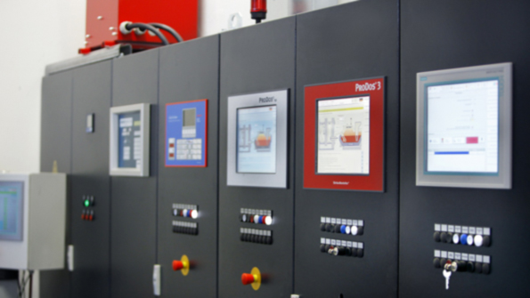

The centrepiece of StrikoWestofen’s presentation at EuroGuss will be the new ProDos 3 control, replacing the current ProDos XP control in the first quarter of 2014, with additional dosing precision and process reliability.
Considerably improved computing power reduces the reaction time by a factor of three, thus adjusting the dosing weight to altered process parameters in a highly efficient way.
“The most important innovation is probably the integration of our patented biscuit correction,” explained Rudolf Riedel, manager of StrikoWestofen. “This has proved to be an effective practical tool for improving the dosing accuracy by another 35%. Its direct integration into the control means that biscuit correction, as well as the standardized DISPO 035 interface to the diecasting machine, is available now to all customers as economical options.
“Electrically and mechanically, the ProDos 3 is completely compatible with the current ProDos XP and DPC control units,” Riedel said.
The new control system is especially resistant to electromechanical disturbances, according to the developer, and is operated via a capacitive touchscreen. This means the controls no longer need to be calibrated, and they are effectively protected in everyday foundry operation via a pane of toughened glass.
