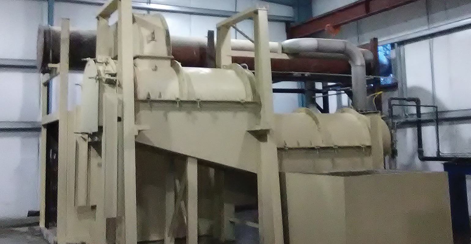

Therefore, Mazdak engineers decided to invent a new furnace that would combine the advantages of cokeless melting and hot blasting. The inventor, Baha Abulnaga, P.E., opted for an inclined chamber set an angle lower than the angle of repose for solid iron. This eliminated the necessity for a water-cooled grate.
The second step was to eliminate the external superheating furnace. A second chamber under the reverberatory flame was connected directly to the inclined shaft. Graphite and alloying elements are added under the flame. The hot gases from the burner rise from the lower superheating chamber to the higher charging and melting chamber in a counter flow to the melting iron. Thus was born the Twin Chamber Cokeless Furnace.
A recuperator was installed for the discharging flue gas, to achieve the merits of hot blasting and to reduce further the system’s CO emissions. By further cooling the flue gas, through the recuperator or past the recuperator through mist spraying or the use of a cooling tower, the carbon monoxide becomes unstable and starves for oxygen, thus transforming itself into carbon dioxide. Flue gases must be lowered to less than 250oC to enter a dust-collecting baghouse until dust generation is lowered to the levels of 40 CFR 63 Subpart ZZZZZ, and those of the toughest regulatory regimes (such as in Washington and California.)  Post combustion is an option upstream of the recuperator, too.

A furnace rated at 2 tons per hour was built. In July 2017, Mazdak won a grant (No. 1721596) from National Science Foundation to proceed with tests and measure emissions, and to optimize the furnace’s performance until the emission levels of carbon dioxide (CO2) are brought down to less than 100 kg/t; carbon monoxide (CO) to less than 7 kg/ton and the dust to less than 0.05 kg/t. The tests will continue until March 2018.
