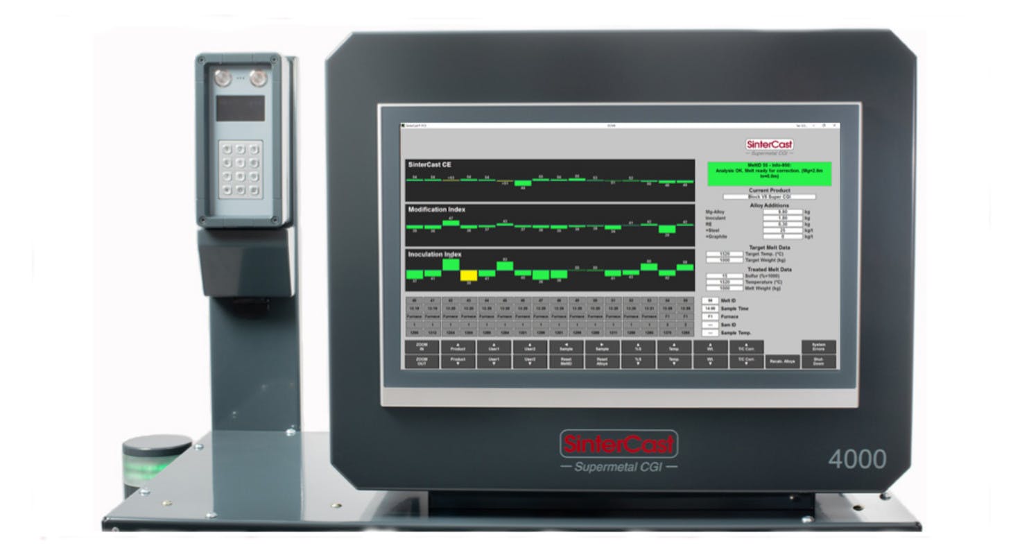

The Mini-System 4000 is a thermal analysis system SinterCast developed according to the established System 4000 unit, for product development, prototyping, and niche volume production of CGI.
With a simplified hardware platform, the Mini-System 4000 uses a separate wirefeeder for manual input of magnesium and inoculant, while providing the same metallurgical process control as the larger System 4000.
As the developer notes, metallurgical formulae derived using the Mini-System 4000 can be transferred to the larger, automated system if the foundry graduates to series production of CGI castings.
