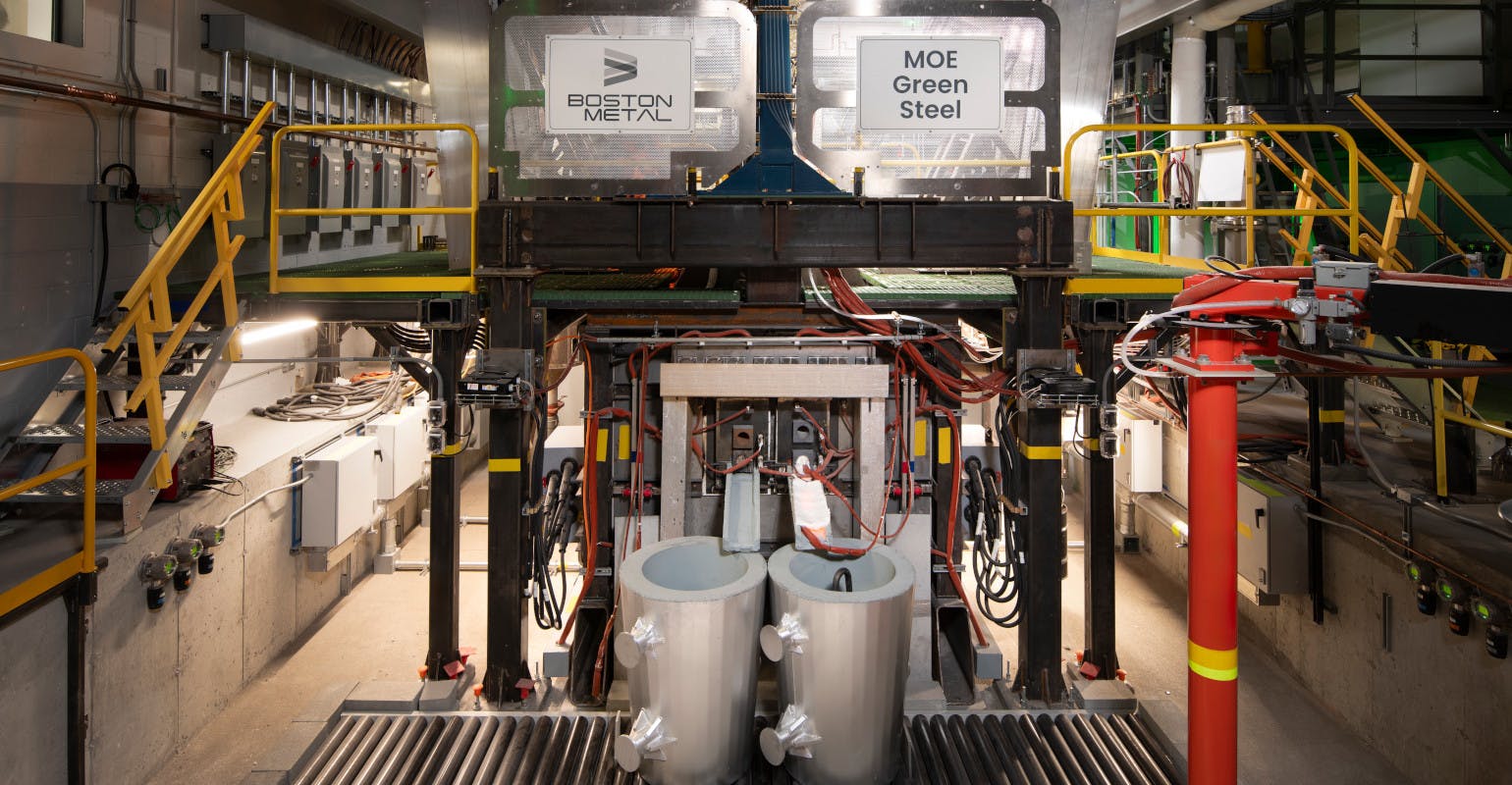

From an idea spawned in a Massachusetts Institute of Technology lab, in 2022 the tech start-up business began scaling up a production cell for its Molten Oxide Electrolysis (MOE) process, to produce iron for steelmaking. The unit (described as a “reactor”) started in January this year, and delivered roughly one ton of molten iron by mid-February.
Like electrolytic production of primary aluminum, MOE uses electricity to separate primary metals from their oxides. The molten iron produced is ready to be converted into steel.
In more detail, an inert anode is placed in the reactor vessel containing an electrolyte solution of ferrous metal oxides. As the solution’s temperature rises to about 1600°C, an electrolytic reaction takes place that separates the oxides and leaves liquid iron.

The developers emphasize that MOE is able to convert any grade of iron ore into liquid metal, without emitting any carbon. A subsidiary business, Boston Metal do Brasil, is profitably recovering metal from mining waste, and the industrial-scale demonstration in Massachusetts proves that the inert anode is able to withstand the heat and corrosive conditions of electrolysis, they report.
Boston Metal’s next step will be to build a larger production cell, according to senior vice president Adam Rauwerdink, PhD. The current reactor proves MOE’s industrial viability, but is not production-scale to deliver a ton or more of molten iron each day. Such demonstration plant should be operational by 2027, though further details are unavailable.
