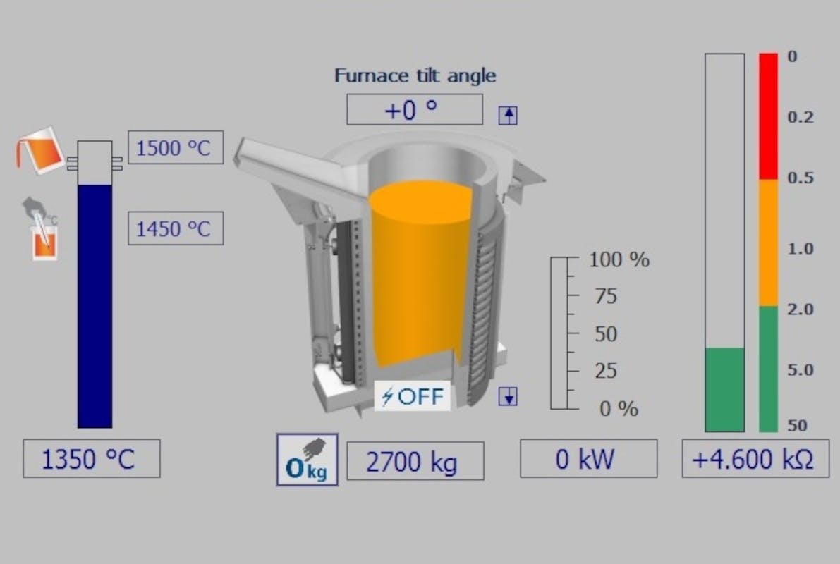

One of the most significant advantages of induction melting is precise chemistry and temperature control. A cupola furnace requires roughly an hour for each melt to reach uniformity. This means that if a sample indicates the need for an adjustment, operators must wait another hour before resampling - a costly delay in both time and productivity.
Induction systems streamline this process. Thanks to inductive stirring, melts become homogeneous in as little as five minutes, so operators can quickly sample and adjust compositions accurately. Optional features like automated furnace charging and advanced monitoring technologies make maintaining optimal chemistry faster and easier than ever.

Induction melting can significantly improve worker safety and make for a more comfortable work environment. With fewer personnel required and automation handling much of the charging and stirring, the number of melt deck workers is drastically reduced - and can often be eliminated when using automated robotic systems like Inductotherm’s ARMS® System. By limiting exposure to hot and hazardous areas, induction melting can create a safer working environment.
