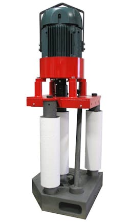

The next major innovation was to apply mechanical pump technology to moving molten aluminum from the furnace to its next point of use. Prior to this advancement, the accepted transfer method relied on gravity, tap-out plugs, and sloped troughs. While gravity is free, these systems make precise control of metal flow extremely challenging.
If the flow is too slow, the metal may freeze; too fast, and turbulence is introduced. Turbulence exposes more aluminum to air than necessary, increasing dross formation and reducing the amount of saleable metal. It also positions workers closer to the molten metal, increasing the risk of accidents. Additionally, gravity-based systems severely limit the options for foundry layouts, as metal must always move downhill.
Enter the transfer pump. Using a standard transfer pump with piping allows much greater control of metal flow, with a variable-speed drive controlling the pump motor. Depending on the height of the required lift, pump speed - and therefore metal velocity—can be adjusted accordingly.
However, piping inherently restricts flow and may introduce turbulence as the metal exits at higher velocity to overcome lift requirements.
So, let’s remove the pipe. The launder transfer pump addresses the velocity challenge by using a “chimney,” allowing molten metal to rise without the restriction of piping. This design significantly limits the aluminum’s exposure to air, with a protective surface skin forming that shields the metal beneath from oxidation. As the metal exits the chimney and enters the launder it flows quiescently to the next point of use without additional dross formation.
In our experience, this method of metal transfer can reduce dross creation by more than 50%.
