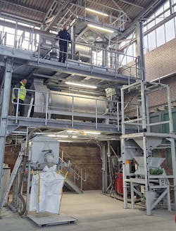

The need for energy saving or energy recovery is not new to metalcasting operators but it has taken on some additional relevance over recent months, particularly for European foundries and diecasters. And energy is not the only savings in mind: the molding and core sands containing organic or inorganic binders represent a resource worth recovering too. Last November, FSP Foundry Sand Processing commissioned a pilot plant for a wet-reclamation process for inorganic-bonded sands, and makes it available to foundries for testing their own sands’ suitability for recovery.

The plant in Stuttgart, Germany, is based on a wet reclamation process patented by DEANTEC GmbH and described as “highly energy-efficient and close to carbon-neutral.” It has a throughput rate of one metric ton per of sand per hour, and FSP claims it will reduce the energy required to dry sand by about 60%. The process removes contaminants from used sands with 98% effectiveness, so the reclaimed material will have nearly equal mechanical strength and flowability as new sand. According to FSP, this means foundries can use it to fulfill up to 95% of their “new” sand requirements.
Compared to mechanical sand reclamation processes, the FSP process is gentler to the material. Binders are removed without damaging the grains, and the process is practically dust-free. The fine-grain fraction of the reclaimed sand is less than 0.3% percent, according to FSP, meaning there will be no additional costs for dumping spent sand.
The sand is not dried with heated air; rather, water is converted from liquid to gas using energy recovered from the condensation stage. Dust particles are removed in a patented fluid-bed cooling separator.
Process water is treated and maintained in a closed circuit. One metric ton of sand generates just 12 liters of wastewater, which represents the only freshwater requirement. Because the distillate is fully demineralized, it is better suited to washing the sand than fresh water.
Also, during the distillation process, condensation energy is recovered. Nearly all (95%) of the energy required for evaporation is recovered from condensation.
