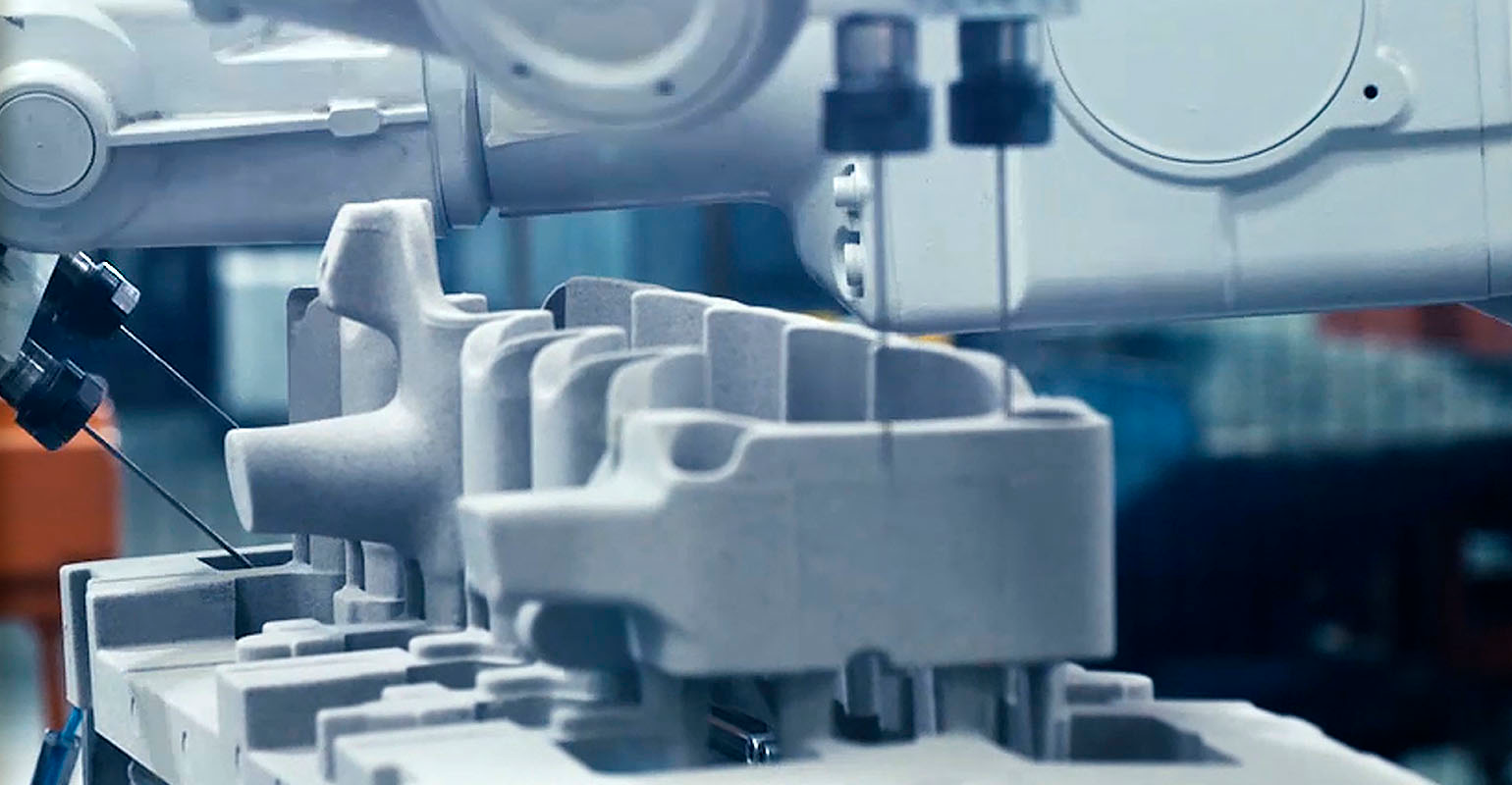

Metalcasters worldwide recognize ASK Chemicals' INOTEC technology as an environmentally friendly and highly productive core manufacturing process for producing light metal castings. Using these thermosetting, inorganic binder systems in high-volume automotive applications prevents emissions during core production, core storage and casting. In addition, the value chain in aluminum low-pressure diecasting and gravity casting processes can make use of its economic and technological advantages, as no condensates are produced from the pyrolysis of the binder system. This generates additional degrees of freedom for temperature control in the casting process.
The faster solidification can result in cast aluminum components with improved metal microstructure. In addition, cleaning and maintenance requirements for the permanent molds are reduced, increasing mold availability and thus productivity.
Until now, inorganic binder systems have been used mainly to produce cylinder heads and crankcases for internal combustion engines. In the course of the diversification of the powertrain in the automotive industry, new fields of application have emerged, so that today central housings for electric motors and structural components (subframes, axle carriers) also are produced with inorganic binder systems.
Thus, INOTEC technology has evolved from a specialty formulation to a diversely applicable binder system in core production. Specific sand core properties – such as moisture stability, shakeout properties, and thermal stability – remain central parameters for inorganic binder system performance.
