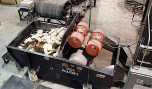

Reclamation equipment — Current reclamation equipment technology also needs to be researched to determine the optimal design to fit a given requirement. Recent developments in vibratory and rotary mechanical attrition, low-level combination decks, shakeout decks with no holes to damage castings, and a number of gas and electric thermal reclamation concepts need to be thoroughly investigated.
