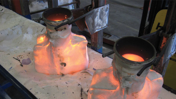

For investment casting superalloys, wrapping molds ensures preheated molds maintain temperatures, fill efficiently, and promote controlled cooling during solidification of the metal. Morgan Advanced Materials developed high-temperature insulating wool blankets that offer offer low bio-persistence, thereby avoiding classification as a carcinogen under European Union regulations.

Mold wrap is an essential part of thermal process control for investment casting for superalloy parts production. It is used to insulate the pre-heated mold, ensuring efficient mold fill, and to provide controlled cooling during the critical solidification of the metal.

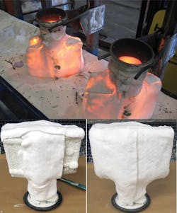

Working with Morgan as their primary development partner, the two companies began a project to pursue use of high-temperature AES as the alternative to RCF. Much of the work was carried out for the aerospace business they supplied, which requires castings with equiaxed or randomly orientated grain structures, using the mold wrap to control the cooling process. The manufacturers required a consistent, thin blanket product with sufficient mechanical strength to be manipulated around complex molds and provide equivalent thermal insulation.
Morgan conducted casting trials using its Superwool® HT, the highest classification temperature AES fiber commercially available (1,300˚C). In the blanket form, the material is 6-13 mm thick with 128 kg/m3 density. Its advanced low bio-persistence fiber manufacturing technology significantly lowers shot content, improving insulation performance and handleability.
The first phase of casting trials on a range of aerospace and IGT products within the engine manufacturer’s foundry confirmed that the castings are manufactured to the same quality standards and exhibit no detrimental effects compared to castings made using RCF mold wrap. The trials determined that the insulation can accommodate the high temperatures required during the mold pre-heat stage while retaining mechanical integrity. The Superwool HT also offers the advantage of not being on the limit of current pre-heat temperatures, allowing the flexibility to increase the temperature further if required.
Subsequent testing measured thermal gradients inside pre-heated molds as they cool to compare the RCF to the Superwool HT wrap materials. Two thermocouples were positioned on the legs of the mold, and then loaded into a furnace held at 1,050°C. The temperature was monitored using a data logger and the mold allowed to soak for five minutes once it reached temperature. Then, the mold was removed and allowed to cool while the temperature continued to be logged. These experiments allowed the selection of the optimum specification of Superwool HT material.
Next the researchers conducted metal-filled mold trials in the foundries and determined the effects on metallurgy. Those results confirmed that Superwool HT material compared favorably to the existing RCF mold wrap product.
Now, both manufacturers have transitioned to using Superwool HT Blade Wrap.
