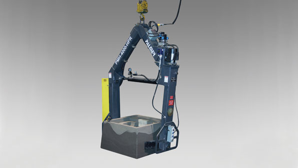

Improper closing is one of the largest contributors to scrapped castings in the no-bake molding process. Internal hooks in the cope can be used to invert and hang the mold on the crane, but this system is slow, cumbersome and potentially dangerous. Mechanical gripper-type mold handlers can be used on smaller molds and gantry-type handlers on larger molds. Both devices grip the mold with pads that normally have pins that extend from the pad into the mold, achieving a mechanical contact between the mold and machine.
Urethane pads have also been used successfully on molds with thinner walls, since less pressure can be required to safely grip the mold. Scissor-type handlers are suspended from the crane on one central point. Gantry-type handlers have pads that come in, usually using some type of telescoping arrangement with the crane trolley on a separate rail above. This allows for the center of balance to be accommodated so the mold can be held horizontally.  Very large molds — those over 15,000 lb — can be handled with molded-in pipe. The handler with matching rods on the pads allows the mold to be handled safely and easily.
