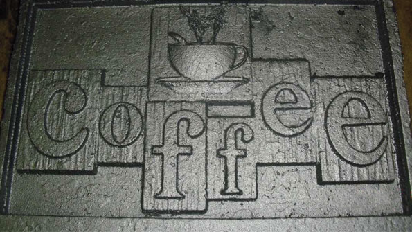

The finished steel casting formed in a foam mold demonstrating a quottransitive manufacturingquot process

An example of a shape produced first by 3DP and then recreated as a steel casting, in an example of “transitive manufacturing.”

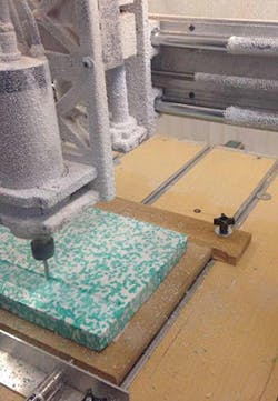

A pattern is machined in foam in preparation for evaporative casting.

“3D-printing of a pattern in order to then evaporative cast it may not be the best choice for all designs: It can be easier in some cases to machine foam stock and glue several pieces together to then evaporative cast it.
