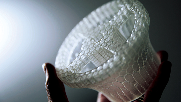

Additive manufacturing (or, 3DP) can be done in many ways, and one of the most common is “stereolithography” (SL or SLA.). In this process, CAD files are converted to .STL format to guide a “printer” (the SL system) to build a 3D structure in successive layers, each one bonded to the preceding one. 3D Systems is one of the primary suppliers of SL technology, with machines capable of producing layers as narrow as 0.002-in., for finished parts with superior dimensional tolerances, smooth surfaces, and fine feature details.
Stereolithography produces three-dimensional parts by interpreting CAD data into the work of a “printer” (the SL system) that builds a 3D structure in successive layers.
So, it’s becoming clearer why, and how, Stratasys Direct Manufacturing is making investment casting its target market. “Tooling costs associated with wax patterns are eliminated when investment casting patterns are made with stereolithography,” Alexander emphasized. “The bigger and more complex the pattern, the better the value proposition for choosing SL versus wax. Complex parts generally take only one or two weeks to deliver. This allows for foundries to help their customer get to market much faster and at a lower cost.”

He noted that Stratasys Direct Manufacturing has started to produce investment-casting patterns with built-in gating systems, which offers several advantages. First, the time and labor-cost savings to the foundry that no longer has to assemble the gating. Next, there is greater certainty of accuracy without manual assembly. And, the chance to review and revise the gating design in CAD adds to the process reliability.
