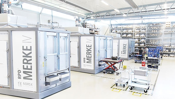

The Plattsburgh plant initially will house 20 NTi-patented, MERKE IV Rapid Plasma Deposition (RPD) process machines, capable of producing 400 metric tons/year of aerospace structural parts, though NTi’s plans call for the plant eventually to have twice as many machines and a capacity of 800 metric tons/year.
The proprietary process involves feeding titanium wire into a set of plasma torches cooled by an argon shield, melting the material into a near-net shape according to a CAD-determined design. NTi claims that the process makes it possible to produce parts that will replace parts currently made by forging, with shorter development and production time. According to a statement, NTi “has signed numerous contracts with the top echelon of aerospace manufacturers and tier-1 suppliers interested in leveraging RPD to cut cost and lead time from airframe and engine programs.”
