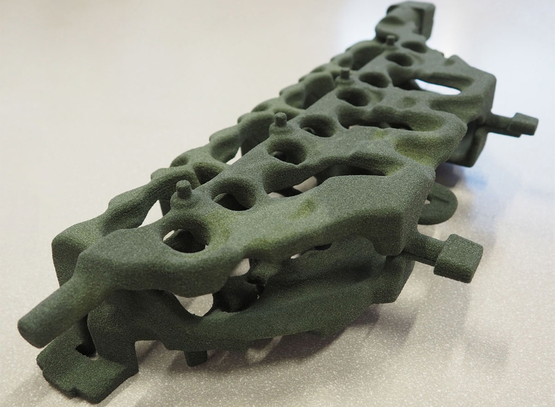

Additive manufacturing of sand cores and molds has attracted the attention of many foundries in recent years due to the process’ unique ability to form core shapes that cannot be manufactured using conventional coremaking techniques. It does this by a process called “binder jetting”: a reactive resin, most commonly, a furfuryl alcohol-based (FA) binder formulated for the application is deposited on a substrate. Typically, the substrate is a silica sand that has been pretreated with an acid catalyst, but it can be a number of other aggregates used in metalcasting, such as zircon and synthetic ceramics.
The FA-based binder is similar to the more commonly known furan no-bake binder that is cured using a sulfonic acid, usually toluene sulfonic acid in water. Once the binder contacts the catalyst it cures in much the same way it will do in a no-bake foundry application.
First, a layer of the pre-treated substrate is spread evenly across a fixed space commonly called a “build box.”. Build box sizes can range from 300x200x150 mm all the way to 4000x2000x1000 mm. The thickness of the pre-treated substrate varies, but usually it is about 0.3 mm.
Next, a print head using technology similar to common ink jet printers, “jets” the reactive binder onto the sand. But, note that it is the manner in which the binder is deposited on the layer of sand that makes the process unique. The actual part geometry is created by the print head jetting the binder only onto the layer of sand in the required shape. This process is repeated until the final 3D part geometry is created.
Advantages of this process are well-known: The part complexity of a casting can be much greater than in typical sand casting because the need for draft and parting lines is greatly reduced; more complex shapes can be created; multiple cores can be combined into one; and multiple different core geometries can be combined into the build-box volume. These are just a few of the advantages.
There are some disadvantages, too: the build box for binder-jetting sand cores and molds is comprised of both bonded and un-bonded substrate. Once the printing process has been completed, removing the core shapes from the build space can be time-consuming and detailed. The cured shapes need to be handled carefully and un-bonded sand carefully brushed or vacuumed away from the part.
