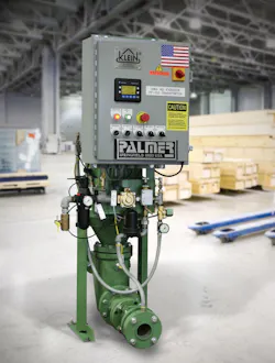

A batch counter should be included in the control panel to track cycles and ensure timely maintenance. As a guideline, the following parts should be inspected at intervals of approximately 40,000 cycles: main seal, inlet cone, vent cone, vent cap, discharge flap, seal ring, and leaf spring. (Note: different designs may include additional or alternative wear parts.)

The main seal of the blow tank will wear over time and must be checked periodically for cracks or deterioration. This can typically be done by observing the inlet cone through the inlet housing sight glass. During a transporter cycle, look for air escaping around the main seal. If the unit does not have a sight glass, the valve must be disassembled and inspected manually.
