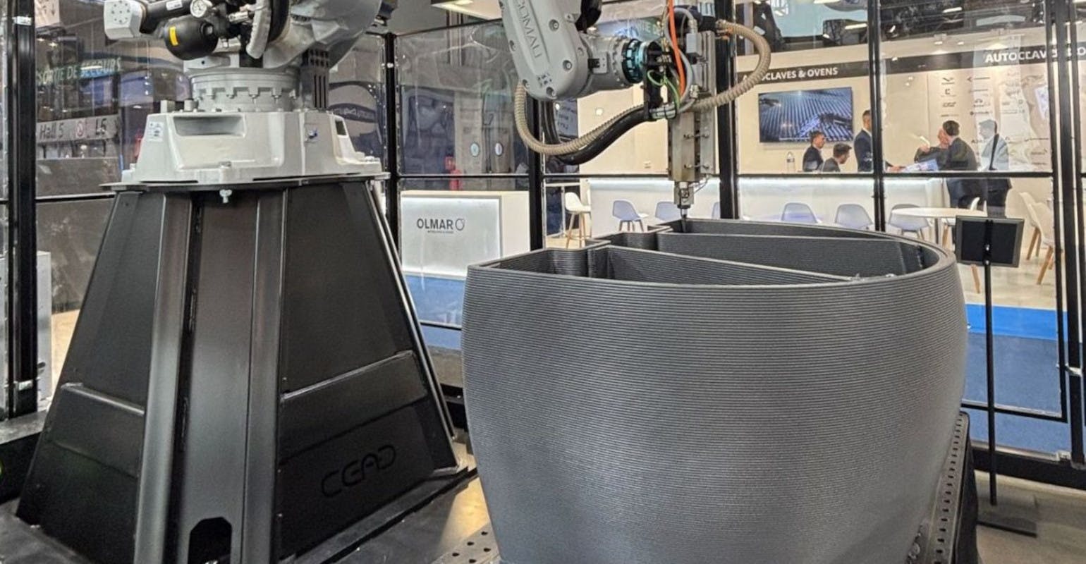

CEAD is a Netherlands-based developer of large-format additive manufacturing systems integrated with subtractive processes and automation provided as turnkey installations. The CEAD Flexbot 3D printer is a large-scale system, housed in a 14x8x5-m enclosure, served by a robotic arm technology. The system combines 3D printing and milling (additive and subtractive technologies) to create a range of complex patterns. It incorporates CEAD pellet-extrusion technology, a Comau robot, Siemens Sinumerik One control technology, a modular worktable (standard size 1.2x1.8 meters), the safety enclosure, and a dryer.

The machine operates across two work tables, one fixed and one rotating. It can print up to 60 kg (132.3 lbs.) of material per hour, and can use various fiber-reinforced polymer materials for large build volumes.
