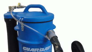

The unit runs on compressed aiir and pairs a proprietary, on-demand air-agitator brush attachment with a high-efficiency pneumatic vacuum.
GUARDAIR CORPORATION offers a new, safe-to-operate vacuum designed to clean dust, powders, and debris from workers’ clothing — thereby eliminating the dangerous practice of self-cleaning with compressed air. “The Personnel Cleaning Station fills a void in the market and supports one of our key strategic initiatives -- our focus on workplace safety,” according to Guardair's Eric Mills, "and it allows us to offer a unique and effective solution to an important safety concern."
OSHA Directive STD 01-13-001 prohibits the use of a “gun, pipe, or cleaning lance” for self-cleaning which might blow “a chip or particle into the eyes or unbroken skin of the operator or other workers.” Use of the Personnel Cleaning Station eliminates this dangerous practice through innovative vacuum technology.
Running on standard shop compressed air, the Personnel Cleaning Station pairs a proprietary, on-demand air-agitator brush attachment with a high efficiency pneumatic vacuum. Thumbswitch-activated, the air-agitator loosens and lifts particles airborne where the vacuum sucks them away safely and effectively. With no motor to burn out, the Personnel Cleaning Station is virtually maintenance-free. The unit mounts on any vertical surface, saving valuable factory floor space. Constructed from rugged polyethylene, the Personnel Cleaning Station boasts an easy-to-empty design.
Weighing 13 pounds, the Personnel Cleaning Station includes a 5.5-gallon container, pre-drilled steel mounting bracket, 10 ft vacuum/supply hose assembly, and air-agitator brush attachment. Featuring a 3/8 FNPT inlet, the unit generates vacuum flow of 73 cfm, yet consumes only 33 cfm of compressed air. Equipped with a standard cartridge filter (77% efficient at 0.8 Microns), or optional HEPA filtration, the Personnel Cleaning Station is backed by the Guardair Forever Warranty, manufactured in the USA, and meets OSHA standards.
