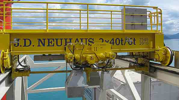

Crane systems manufactured by the J D NEUHAUS company can be supplied with Atex classifications EX II 2 GD IIA T4 / EX II 3 GD IIB T4, with increased spark protection also available for explosion level II C. The products are used worldwide, operating in some of the most dangerous dust-laden conditions, as well as hazardous, toxic, and potentially explosive atmospheres.
Typical applications include foundries, mining, tunneling, cement plants, with toxic and hazardous locations including chemical processing, while oil-and-gas production on land or offshore involves some additional heavy load-handling requirements.
J D Neuhaus cranes are insensitive to dust, humidity and aggressive atmospheres as standard, operating within a temperature range of -20°C to +70°C. They provide 100% duty ratings with no downtime and only minimum maintenance requirements. Overload protection and fail-safe braking are incorporated, together with emergency-stop safety features. Special limit switch arrangements for end-travel, anti-collision and protected zone status are also incorporated as required.
All load lift, lower, and traverse operations operate off a pneumatic air-line pressure of 85psi (6 bar), with optional hydraulic operating systems also available. This eliminates the potential hazards and dangers associated with electrically powered equipment when operating within areas of high dust or humidity.
The JDN range covers both single- and double-girder overhead travelling cranes, together with slewing jib cranes and underslung cranes incorporating purpose designed low headroom hoist trolley designs. Cranes with individual hoists having load capacities up to 100 metric tons can be supplied, as well as multiple hoist crane products operating with single or twin parallel beams, while also providing individual or synchronized hoist control systems.
Cranes can be supplied with rack-and-pinion drive systems for safe operation even in bad weather conditions. Super-silent operation is combined with sensitive controls including an automatic safety function for load-lowering in the event of power supply failure.
Special purpose, fully customized cranes can also be supplied to customer specifications. For companies looking for self-build projects, JDN also supplies crane kits. These are designed for the manufacture of overhead travelling cranes and underslung cranes. They feature the use of a single-span beam providing the hoist support and running platform. This includes both overhead travelling and underslung mountings which are supplied with crane drive motors and space saving energy chain systems for the power supplies for both long and cross travel movements.
Customized products that have been supplied include a hydraulic semi-portal crane, with a lift capacity of 80 metric tons for use on a drilling rig. This incorporated twin monorail hoists, together with four JDN hydraulic drives for the crane travel movements.
Other specialized products for the oil-and-gas industry include an 80-metric ton double girder overhead travelling design for ‘Xmas tree’ handling on a semi-submersible rig. Another purpose-designed product provided a 200-metric ton lift capacity for handling BOP equipment offshore.
Cranes for use in the corrosive atmospheres of the galvanic industry have also been supplied.
