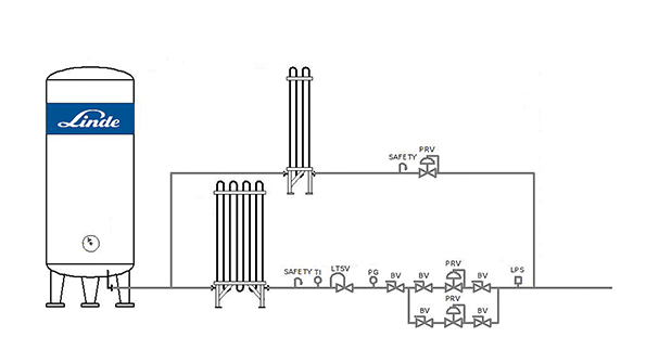

The Linde LLC protective-atmosphere safety system is designed to monitor the supply of nitrogen needed to purge heat treatment furnaces. The alarm panel displays 1) emergency purge low, 2) nitrogen gas temperature – low, and 3) nitrogen final line pressure – low.
LINDE LLC helps companies operating heat treatment furnaces to improve safety by installing a protective-atmosphere safety monitoring system in compliance with the National Fire Protection Association’s “Standard for Ovens and Furnaces” (NFPA 86).  Heat treatment furnaces depend on nitrogen supply to help operators initiate a safety purge with inert gas of the flammable atmosphere, and NFPA 86 requires proper monitoring and controls to reduce fire and explosion hazards. The Linde safety solution is designed to monitor nitrogen supply levels, and signals operators to low conditions with an audible alarm and strobe.
To help ensure availability of supply for the flammable atmosphere nitrogen purge, the integral alarm panel provides indicators for low liquid-nitrogen level, low nitrogen pressure, and low nitrogen-supply temperature.
