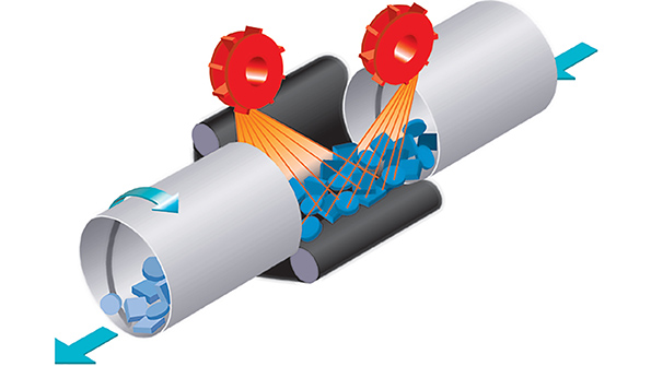

The centerpiece of all CT machines is a continuous apron conveyor that reliably tumbles parts for all-round blast coverage.
The blast wheels are arranged to cover the width of the apron conveyor, pointing directly into the ‘apron’, where the parts are being tumbled along. Blast intensity is controlled by varying the part throughput rate.
Exposure of the workpiece to the abrasive stream is controlled by the volume of castings, resulting in the best possible cleaning effect and minimal wear on machine components and abrasive. Barrel rotation speed and abrasive throughput are electronically controlled, based on preprogrammed parameters.
