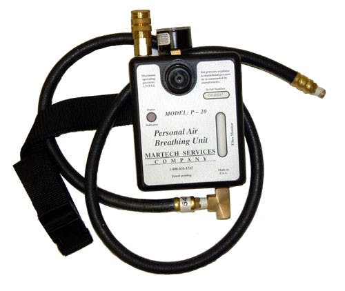

The MARTECH SERVICES CO. Model P-20 personal air breathing unit will ensure workers achieve compliance with the OSHA requirement for Grade "D" Breathable Air. The regulation requires respirators to supply air that meets specific purity standards: oxygen 19.5-23.5%, hydrocarbons ≤ 5 mg/m³, carbon monoxide ≤ 10 ppm, carbon dioxide ≤ 1,000 ppm, and no odor.
According to Tom Wright, Director of Sales and Marketing, when used properly the Model P-20 personal air-breathing unit will work with the existing filtered compressed-air supply.
It will provide Grade "D" breathable air for a proper NIOSH approved respirator, and with the provided 54-in. tool air-hose assembly it will allow for a by-pass of air for a paint spray gun.
The Model P-20 is a 20 SCFM system, allowing for use with full hoods, equipped with vortex cooling tubes, if desired.
The unit is a complete, belt-mounted system with a built-in filter with filter monitor, and a carbon monoxide monitor with both audible and visual alarms. The monitor runs on a single battery, and continuously monitors the air for compliance with current OSHA standards.
