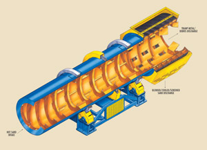

Final Cooling - The third stage is the most demanding. As the sand temperature is lowered to ambient air temperature, more time and air volume through the sand is required to provide adequate cooling. A method of bringing the sand temperature down to 45° C (115° F) is by using a rotary sand blending/cooling/screening drum.
Sand Cooling Drum
In the first section of the drum, helical flights mix and homogenize the sand thoroughly. As the sand cascades downstream through the drum, counter-flow air evaporates the moisture and cools the sand. The back blending and intermixing within the drum blends the various zones of the mold and mixes in unpoured molds so the sand is consistent in temperature and moisture upon discharge. At the discharge end of the blending/cooling drum, a separate source of air is pulled counter flow through the sand screen. The result is a temperature drop through the drum of 40° C (70° F).

Sand cooling drums are available in sizes from 10 to 1000 tph. The rotating action provides constant exposure of fresh surface area to the air flow to achieve the highest degree of sand cooling. The integral sand screen at the end, provides the greatest amount of air to the surface area of the sand grains.
