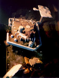

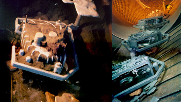

Un-molded castings prior to rotary media processing.
Controlling Airborne Sand — The second source of airborne silica dust is sand still attached to the castings after shakeout (in pockets, cavities, and corners). As heat from the metal drives out the moisture, the loose sand falls off and contaminates downstream operations.  Workers in cleaning, finishing, and melting departments are exposed to silica dust.
Dust is also generated when these “sandy” castings are shot-blasted. The sand that goes into the shot-blast system contributes to wear on the equipment, but it also degrades and adds to the waste stream. This translates into increasing

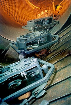

Cleaned castings exiting the rotary media drum.
