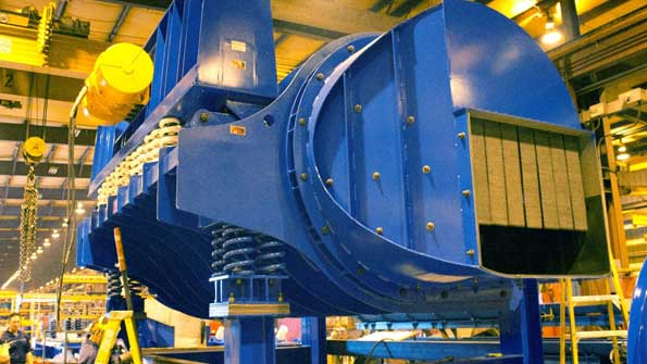

The age of the foundry’s existing cleaning equipment, as well as the need for expansion and incremental capacity increases, prompted General Kinematics to suggest its GK VIBRA-DRUM® process as a solution to all these issues.
The VIBRA-DRUM® is “two-mass, sub-resonant tuned” system that compensates for variations in load size and weight. Its continuous tumbling action loosens sand from the castings, and accelerates casting cooling by equalizing the sand/casting temperatures and evaporating moisture. At the same time, the action reduces sand lumps to granular size, and blends the shakeout sand to equalize its temperature.
Because the tumbling action is gentle, the VIBRA-DRUM® keeps the castings in a bed of sand; the parts are never dropped or subjected to excess impact during shakeout.
As noted by General Kinematics, “natural frequency vibration produces a beneficial, drum-like material rotation that quickly reduces sand lumps without casting damage.” It added that system is easy to maintain, with all the environmental benefits of a totally enclosed drum but with no air handling, sealing, or interface problems.

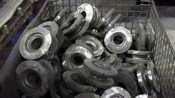

Casting cleaning. The GK VIBRA-DRUM® would use the mold sand as a form of “media” that would flow through and around the castings, giving some additional cleaning/scrubbing action.
The GK VIBRA-DRUM® test unit was installed and positioned in an area of the plant where the newly poured molds could be handled easily. Testing consisted of continuous monitoring of the sand and casting temperatures with an infrared temperature gun. For comparison of the prior casting/sand cooling process to the GK VIBRA-DRUM® sequence, molds were broken on the foundry floor to measure comparative temperatures. Sand and casting temperatures gave the needed point of reference for overall cooling times.
Several tests were conducted to determine what could be achieved with the installation. By the final test, when the mold was cracked there was an insignificant amount of ignition as the casting had more in-mold cooling time before it was handled. Even so, the large lumps of sand broke down smoothly and the castings began to tumble very quickly, which was the desired action.
The VIBRA-DRUM® had a good stroke action to get the flow climbing the active side of the liner, even with these larger, heavier castings. The test unit improved the overall shakeout process, achieved better results than were originally outlined, and the system is able to run harder, longer, and faster. The critical benefits of using this technology included:
Casting cooling.  Cooling curves confirmed the expected results that the sand and castings would reach an equilibrium temperature. In all of the tests that equilibrium temperature proved to be roughly 500°F in approximately 10-12 minutes, depending upon the casting temperature as it entered the VIBRA-DRUM®.

Casting cleaning. Visually the castings appear “cleaner” than most of the castings being air-cooled after extraction from the GK VIBRA-MILL® installed for the previous production sequence.
