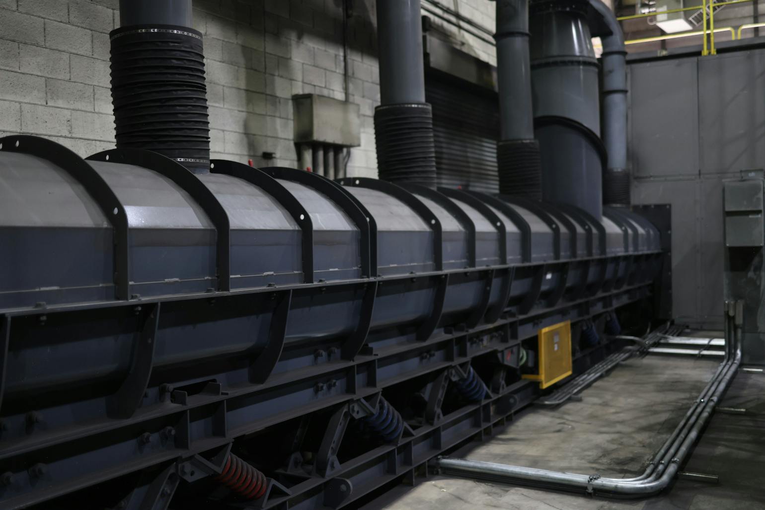

Vibratory conveyors are an excellent tool for this, as they withstand heat, and can screen sand and contaminants away from the castings. And conveyors can be designed to perform sorting, despruing, and more, all in one unit. With properly designed transitions and hooding, dust and noise can be contained, which will lead to a cleaner and quieter foundry. Worker interaction with the products and return materials will be reduced too, as fewer operators are needed to move material around the plant.

Recently, General Kinematics was approached to upgrade the process flow at Kirsh Foundry in Beaver Dam, WI. Before installing the new equipment, they were moving everything manually, placing the hot castings in tubs and waiting long periods for them to cool off post-shakeout. The time between molding and shipping was 10 to 12 days.
Now, with the addition of casting cooling conveyors and shakeout equipment, castings are sent to grinders and finishers within a day of casting.
“It's the smoothest that it’s been in my lifetime here. We look for three things: safety gains, productivity gains, or environmental gains. And this project satisfied all three. It's made a huge difference, and it's much more efficient and a much better place to work,” according to Kirsh Foundry CEO Jim Kirsh.
