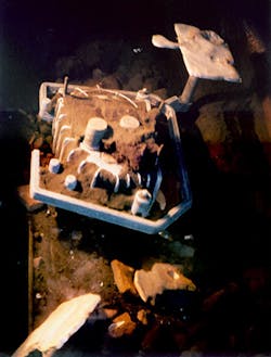

Un-molded castings prior to rotary media processing.
Controlling Airborne Sand — The second source of airborne silica dust is sand still attached to the castings after shakeout (in pockets, cavities, and corners). As heat from the metal drives out the moisture, the loose sand falls off and contaminates downstream operations.  Workers in cleaning, finishing, and melting departments are exposed to silica dust.
Dust is also generated when these “sandy” castings are shot-blasted. The sand that goes into the shot-blast system contributes to wear on the equipment, but it also degrades and adds to the waste stream. This translates into increasing

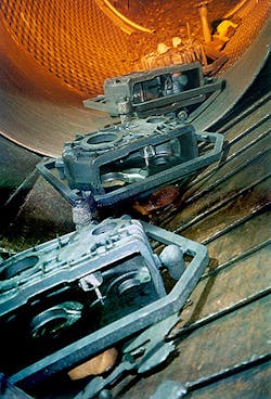

Cleaned castings exiting the rotary media drum.
sand-disposal costs. The sandy returns that go back to remelt without being shotblasted, lower the melting efficiency and increase the volume of slag, the need for slag handling, and slag-disposal costs.
Didion innovations in sand-casting separation and cleaning have helped foundries in their determination to make their operations cleaner, and to lower operating and labor costs.  These innovations have led foundries to achieve hundreds of thousands of dollars in annual savings.
Multi-purpose, single-step — The Didion® Mark 5 Series Rotary Media Drum is a patented design that performs shakeout, sand conditioning, double sand screening, casting cleaning, and casting cooling in a single efficient step.  Foundries stay much cleaner because airborne silica dust declines, and it offers the lowest operating cost-per-ton of any comparable package available to the global foundry community.  Didion projects that combining these processes will cut operating costs by $40-80 per ton.
Foundries benefit in a number of ways, including: less capital equipment to purchase; less floor space occupied; much lower energy costs; less maintenance time and cost; lower shot consumption; fewer replacement parts; cleaner working conditions; and cleaner returns to remelt, which reduces slag build-up.
The Mark 5 Series streamlines production with cool and clean castings going directly to the finishing department. Return sand is blended and conditioned, so it is consistent in temperature and moisture content, and provides better control at a mixer. Sand stays in the system where it belongs, so the foundry stays cleaner.
Dust collection is highly efficient thanks to the drum’s small, open area. It requires 75% less dust collection than a vibrating shakeout rated at the same capacity.  Counterflow air eliminates fugitive dust from escaping, protecting workers from airborne silica dust.
Many foundries shot-blast their castings twice: first to pre-clean the castings and returns; then, after casting grinding, to blend in the grinding marks. Because the Mark 5 also cleans the castings, the first shot blast step can be eliminated.  Gates, runners, and sprue are often removed in the Didion system, so there’s no manual labor involved and the clean returns go directly to remelt.
