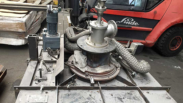

ZPF supported the collaborative project on fundamental questions, and took care of the software development, as well as the installation and testing of individual system components. In addition, it was responsible for the test phase, using a demonstrator, and for the industrial implementation and testing.
"For the field experiments, a demonstrator that was closely based on a series system (melting furnace, type SG 1.5T5, with a melting capacity of 1.5 mt/h and a holding bath capacity of 5 mt) was installed,” according to Sauke, “but it was equipped with a large number of special components, as required for the project type, such as those required for the entire measuring equipment.” Based on the coordinates transferred to the burner control by the measuring system, it was possible to swivel the system to the desired position via two servomotors. As a result, melting times could be reduced — without the quality being impaired — at a lower rate of gas consumption.
"Our initial expectations of 10 to 15% reduction in energy consumption have been met,” Sauke confirmed. “Measured data allow for the conclusion that this increase in efficiency is based on a reduction of the melting down time.”
