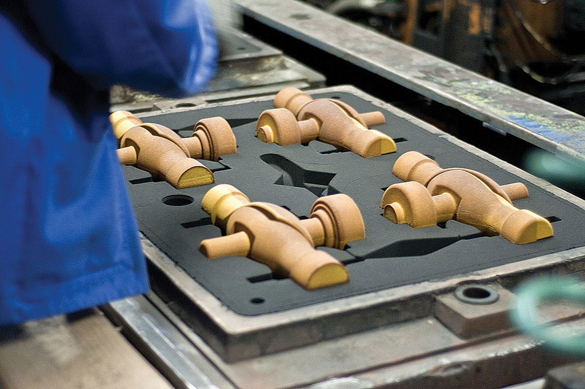

As the acronym indicates, the PUCB process is based on the reaction of two components with polyurethane. A polyaddition of one component (Part 1), the phenol-formaldehyde resin, and the second component (Part 2), the isocyanate, is initiated through basic catalysis, usually by means of gassing with a tertiary amine. The hardening reaction is very fast, which makes the PUCB (or simply, cold box) process attractive for high-volume, high-productivity production of series components. The high strength level enables fast and automated core production with process reliability. The cores can be cast just a short time after production and feature high thermal stability, which also allows the dimensionally accurate production of water jackets or oil duct cores. Due to their almost pH-neutral properties, high proportions of mechanically or thermally treated used sands from cold box production can be reused.
Regarding VOCs, traditional PUCB’s are comprised of organic materials that will contribute to VOCs, odor, and smoke – and to some extent this is unavoidable. Nevertheless, the VOCs are generally a concern during coremaking and storage. The odor and smoke, however, are related to the pouring, cooling, and shake out of the casting.
These organic compounds are found in both the Part 1 and Part 2 of the binder system, so reducing the amount of binder or looking at newer formulations could help with the sustainability of your operation.
Frequently, optimizing the cold-box tooling can reduce the amount of binder and curing agent needed to produce a sound core. A baseline simulation of the tooling set-up often may lead to tooling modifications (e.g., vents / blow tubes) that would produce cores with less resin resulting in lower emissions. Arena-flow simulation software is commercially available to tooling engineers via ASK Chemicals Design Services Group. The Arena-flow software is remarkably precise and newer versions provide simulations that are extraordinarily accurate.
