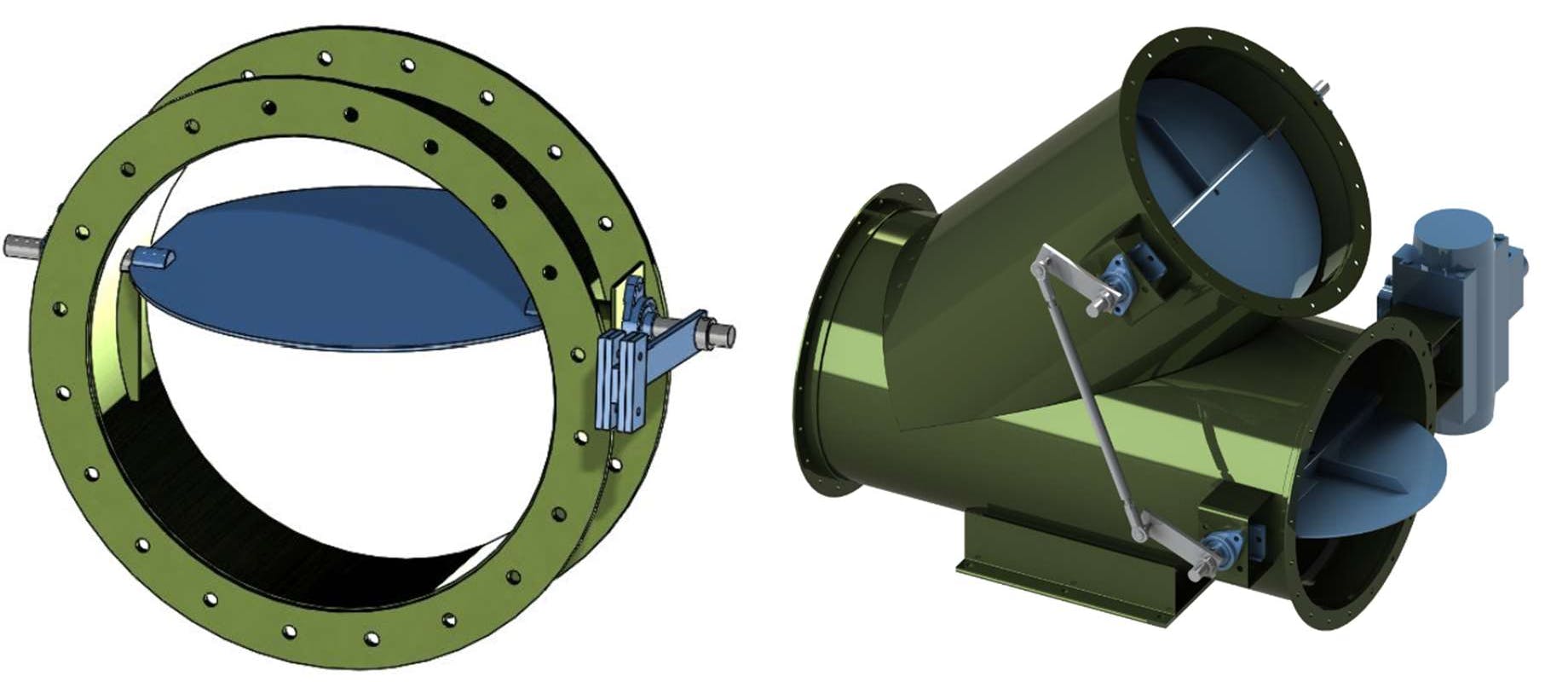

Types of dampers in foundries
These industrial facilities face particular airflow challenges, like extreme heat and hazardous fumes, making it important to select the right type of damper. A few different types used in foundry settings include:
Volume control dampers. Wafer, butterfly, and other volume control (VCD) dampers regulate the amount of air flowing through different sections of the ventilation system, balancing airflow across the foundry and ensuring that high-heat or high-dust areas receive proper ventilation.
Backdraft and isolation dampers. Backdraft dampers prevent air from moving in the wrong direction, preventing fumes or hot air from entering clean areas. Isolation dampers, like guillotine or slide gate dampers, allow specific sections of a duct system to be shut off, making emergency containment or maintenance easier and safer.
High-temp capabilities and refractory dampers. High-temperature and refractory dampers are specifically designed to withstand the extreme heat and corrosive conditions found in melting and casting areas. Constructed from heat-resistant materials and lined with refractory insulation, these dampers maintain structural integrity and reliable airflow control even in continuous, high-temperature operations.
Motorized or automated dampers. These adjust airflow in real time based on process demand, pressure, temperature, or other factors, reducing the need for manual adjustments and maintaining consistent air quality.
