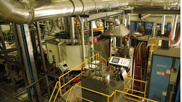

Melting and Pouring
It’s difficult to conclude that singular function of foundry is the most important, but the melt deck might qualify for such a claim. Certainly for WWT, which developed the foundry to manage a high-volume stream of lead-free bronze products, the two Inductotherm Corp. furnaces selected to melt the metal to 2,100°F were critical selections. Melting and tapping are conducted from each furnace in alternating cycles. An auto-pour system is installed to receive the metal, remaining full at all times, with inert-gas pressurization to reduce any inconsistencies in the pouring process that may lead to solidification defects.
“We chose Inductotherm equipment for the melting furnaces and the auto-pour system,” Tyler Stone explained, “and for several reasons. First, they are a good company. Second, we already operate Inductotherm equipment in the existing foundry, and we’re familiar with it, and had worked with the systems in the past.  After we looked at everyone, we decided to stick with Inductotherm for this new foundry.”
Noting that the WWT operators continue to work toward full capacity, the new furnaces have performed well during the first months of operation. That’s true for the auto-pour system too, the general manager said, and the selection of Inductotherm’s auto-pour system has been advantageous inasmuch as the coordination of melting and pouring is a critical interface for the entire operation.
“You know, building a foundry is a complex undertaking, and we were pressed for time,” Stone observed, “so it made good sense to stick with common equipment. We had to work out some wrinkles, but auto-pouring is doing well for us right now.”
