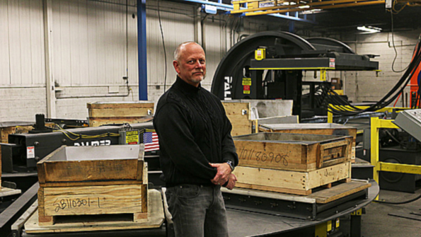

Astech Inc president Alan Bukach showing the new Palmer Manufacturing amp Supply mold carousel

The new Palmer, eight-station carousel line is dedicated to producing no-bake molds. It will accommodate molds with maximum dimensions of 50x72x48. The maximum weight for cast part is limited to 900 lb.
“Our new no-bake line has increased production significantly,” according to Astech president Alan Bukach. “Adding automation to our no-bake process has improved our mold quality and downstream processes as well.
“The Palmer core blower affords us a great deal of flexibility in adapting to a wide spectrum of core configurations,” he added.”
