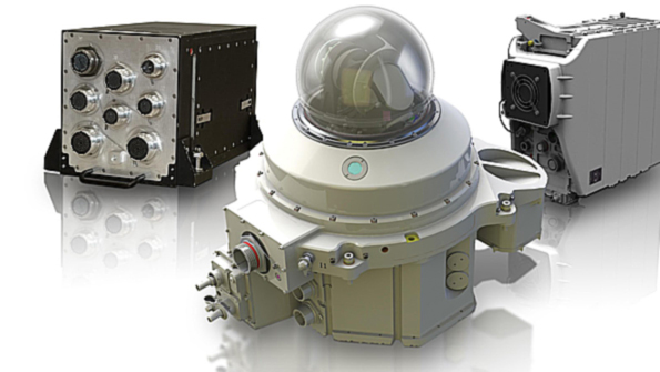

Materion Beryllium & Composites reported it made its first delivery of finished aluminum-beryllium investment castings to Lockheed Martin for the F-35 Lightning II Electro-Optical Targeting System (EOTS), an air-to-air and air-to-surface targeting system on the fighter jet built by Lockheed Martin and numerous suppliers for the U.S. Dept. of Defense.
The EOTS is described as the first sensor to combine forward-looking infrared and infrared search-and-track functionality. It reportedly improves F-35 pilots’ situational awareness and helps them to identify areas of interest, perform reconnaissance, and deliver laser- and GPS-guided weapons with precision.

Materion installed investment-casting capability two years ago at its Elmore, OH, complex to produce the EOTS parts using its AlBeCast alloy, and partnered with Aristo Cast Inc. to perfect its processes. The finished casting previously passed Lockheed's first-article-inspection (FAI) testing.
According to Materion, AlBeCast investment casting alloys are 25% less dense than aluminum, and have four times the specific stiffness of aluminum, titanium, steel, and magnesium. They have higher dampening capacity than aluminum and a coefficient of thermal expansion almost 50% lower than aluminum.
