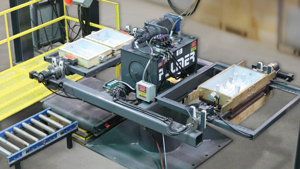

Green sand to no-bake molding system — The basic Palmer UMM rotary molding system is designed to use existing green sand or no-bake tooling to produce no-bake molds at a rate of 20 per hour, in sizes from 12x12x4/4 to 26x36x20/20 with one operator.
Other UMM sizes are producing at rates that are equal to or close to automatic green-sand molding machine production rates of 65 molds per hour, in sizes from 12x12x4/4 to 36x36x12/12, with two or three operators, depending on the design.
Existing green-sand matchplate machines have simple wooden boxes mounted to them and cope-and-drag boxed work is mounted back-to-back on the tooling frames (essentially, a matchplate design.)  After the boxes are filled, compacted, and struck off, they are indexed. As a filled box is indexed toward the fill station, it is inverted.  A precision scissors lift rises to the inverted mold surface, which receives the mold half and lowers while the opposite half is being made.
As soon as the scissors lift is in the down position, the conveyor on top starts running the mold half out to the mold prep area.  This allows for any amount of daylight desired, at the same cost and with no effect on the mold production rate.
Larger UMM systems have been produced in sizes up to 60x60x30/30 with production rates of over 20 molds per hour, with one operator – and no rollover!
With this UMM design, cope/drag boxes are mounted on a platen that is isolated from the main machine frame with omnidirectional isolators.  This platen is inverted using hydraulic rotary actuators.
Six to eight of these platens are arranged on a carousel system where the box is filled and compacted with an on-board vibrator, indexed, and when the sand sets up inverted, to be drawn with a scissors lift as described above.  Again, this design allows for 6 ft or more of daylight without a rollover machine.
