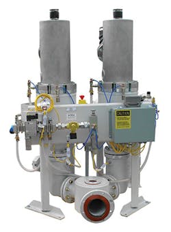

The high-density system has been introduced successfully to North American foundries, after excellent results for European foundries over many years. The high-density system is different from dilute and dense phase systems because it uses higher pressure air, up to 85 psi, and moves the sand in the form of slow moving slugs at approx. 350-450 fpm through the pipe run with no need of boosters. Having an even lower air-to-material ratio than either the dilute or dense phase systems, the high density system results in only minimum pipe wear and negligible sand degradation. In the high density system the sand is never fluidized.
Comparing a pressure phase diagrams of dense phase and high density systems we note that starting out at a given pressure, the dense phase system (because fluidization has to be maintained) requires boosters approximately every 20 ft., which adds more air to the fixed-diameter pipe, increasing the velocity of the sand.
The high-density system, because fluidization is not required, uses the full energy of the expanding air to push the slugs of sand toward the receiving bin. This system is able to push sand approximately 350-400 ft. in one shot, and if longer distances have to be covered sand is dropped into an intermediate hopper and a second blow tank is installed in series.
Typically, maintaining the integrity of the sand grains and the low maintenance required in this system far outweigh the increased cost of staging.
A high-density system can deliver raw sand just like water flowing in a piping network, with each use-point being equipped with a valve to refill a hopper on demand. The high-density system is ideally suited to deliver sand to multiple discharge points, and is being applied frequently to “just in time” sand delivery to individual core sand mixers.

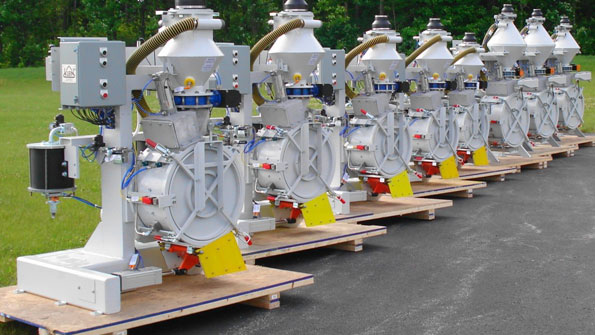

For jobs using only smaller amounts of sand, such as short-run or higher production core machines, smaller batch type mixers have gained popularity. Capable of small batches (up to 100 lbs.) in just 45-50 seconds, these smaller mixers deliver just enough sand to keep a core machine operating without allowing excessive aging of the mixed sand before use. In most applications these individual mixers operate completely automatically and are equipped with sand and binder metering devices.
There is a growing awareness that smaller sand volumes (just enough to make one blow) not only saves wasted sand but enhances core quality and binder requirements. This applies especially to larger-volume, cold box core production, where using sand directly from the mixer prevents excessive evaporation of volatiles in the sand mixture, which also benefits the properties of cold box cores.
Various medium- to high-production foundries have switched from the large volume batch or continuous mixers to these smaller batch-type mixers that allow individual setting of binder volumes for different jobs on specific core machines. Typically this type of small automatic batch mixer is equipped with a mixing bowl that holds the sand, with rotating blades driven by a vertical or horizontal shaft (which also may be located above a core machine), with mixed sand dumping directly into the core machine sand hopper.
There are several ways to distribute the mixed sand. Single continuous mixers filling large molds in no-bake operations, directly, and batch mixers with moving trolleys filling hoppers above rows of core machines.
But, to benefit from small sand charges for several core machines with lower production, smaller batch mixers can be mounted stationary, discharging into a trolley or clamshell bucket that delivers sand to individual core ma­chine sand hoppers. Other applications are possible where the entire mixer is mounted on a mobile frame on wheels, to deliver sand directly to the core machines. Mixing starts upon receipt of a signal from the core machine needing sand.
