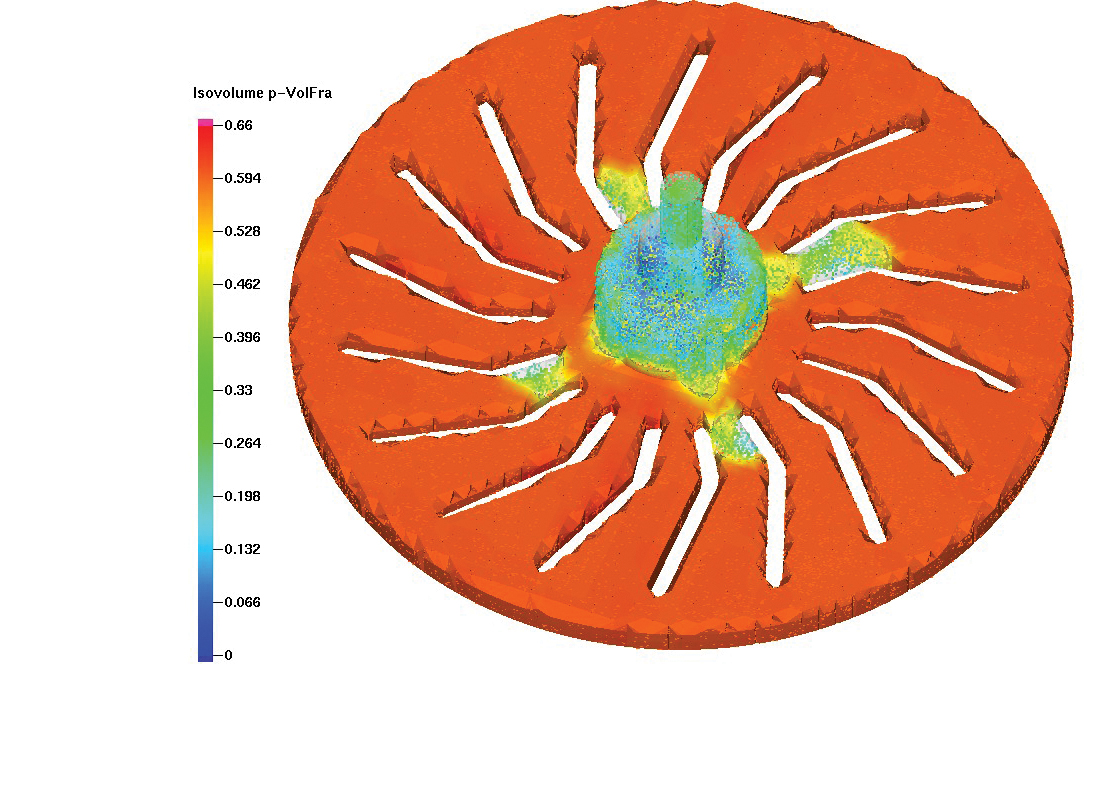

Arena-flow® is a CPFD® (computational particle fluid dynamics) simulation software that models the true physics of blowing and curing core sands. As you can imagine, sand and fluids flow quite differently, and CPFD is the best way to get an accurate and reliable picture of the complex flows that happen in the blink of an eye.  Analyzing the visualized core throughout blowing and curing provides insights into the process and can be used to identify and correct core defects.
One of the most common core defects is sponginess, or unfilled portions of the core cavity. This is the result of sand compacting early in the blow cycle, before the sand/air mixture has a chance to fill in areas far from the blow tubes. Vents that are beneath blow tubes (or near invests on vertical tooling) will steal air flow, preventing it from reaching other areas of the core. Blocking vents can be tested easily, but adding vents requires sending the tool to a pattern shop, which requires both time and resources, and may not even fix the right defect!

Another common type of blowing defect is seen on multi-cavity tools, or family boxes, where cavities toward the outside of the blow hood frequently will have issues, while cores in the center will be fine, quality-wise. It’s usually ideal to fit as many cavities as possible in a core box, but you can simulate the effects of different cavity layouts before tooling construction starts. By taking into account the geometry of the sand magazine and simulating the whole core machine during blowing, a full understanding of the cycle can be achieved. A partially filled core that has sand missing directly under a tube or invest area is evidence of a rat hole, which can be easily seen in the simulation and fixed in a variety of ways, such as sand savers and diffusers.
Gassing-related defects, such as rubbery or uncured cores, can be diagnosed, too. Portions of the core cavity that have stagnant air flow, or uneven curing-gas front movement can be visualized, quickly identifying problems. The effects of adding additional vents to deep pockets or slow-curing areas can be simulated to see cycle-time reductions, before costly physical changes are made to the tooling.
