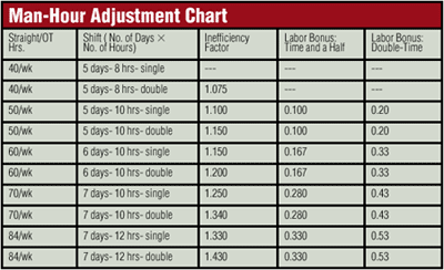

Understanding the computation of labor and the difference of work schedules can eliminate or avoid cost and schedule overruns. Labor adjustments occur when the "schedule of work" affects the productivity of the labor force and the amount of time required to perform the required work, such as "schedule of work." Labor costs calibrations are based on adjustments to the number of hours and days worked during a given week. The "schedule of work" dictates any adjustments to man-hours and labor cost. (The chart on p 32 demonstrates some common work schedules.)
Based on this chart, a longer work schedule, more hours worked, and more shifts required will adversely affect the total project cost, and could impact the construction work schedule. Historical data would support the inefficiency factors listed above and/or show when those factors should or should not be used.
