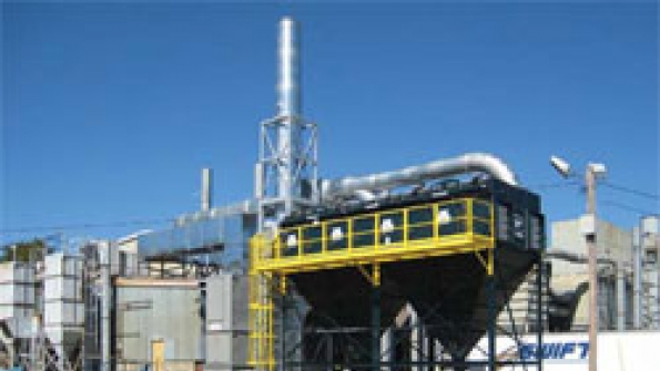

A high-efficiency pleated bag-style (cartridge) dust collector is used to handle foundry sand containing lead and other metals.
