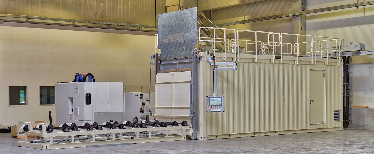

Now, the demand for automotive aluminum castings has given rise to a new concept: centralized management and handling of the heat-treating process, with customized process expertise. Belte founded Aluvation, which via its Aluvation Technology Center in Paderborn, Germany, offers heat-treatment to aluminum parts manufacturers not in capital-intensive installations but via a modular, digitalized, and transportable process.
By using mobile, scalable, and standardized furnaces designed like shipping containers, Aluvation oversees high-tech heat-treatment activities that are connected via an Industry 4.0-tuned data network. Customers rent a heat-treatment plant, including process development service, according to their specific needs and the particular volume requirements; it can be installed within days; and integrated into a production program. The electric-powered furnace modules can operate anywhere in the world, centrally controlled from the Aluvation Technology Center.
Heat-treatment (T5, T6, and T7) capabilities range to allow different metalcasting operations to choose the right type of installation for their products and business plan.  Stress relief, recrystallization annealing, stabilization annealing, and soft annealing are offered.
One or more continuously variable electric-heated modules can be selected, to perform heat-treatment in a temperature range of 80-550°C, with temperature uniformity of +/-3°C. Maximum system dimensions are 5,400×1,700×1,700 mm, for parts weighing up to 6 metric tons.
With truck transportation available, the heat-treating system can be set-up and commissioned in one to five days (depending on the number of linked modules), and all process planning, monitoring, documentation, and archiving is managed at the ATC in Germany.
