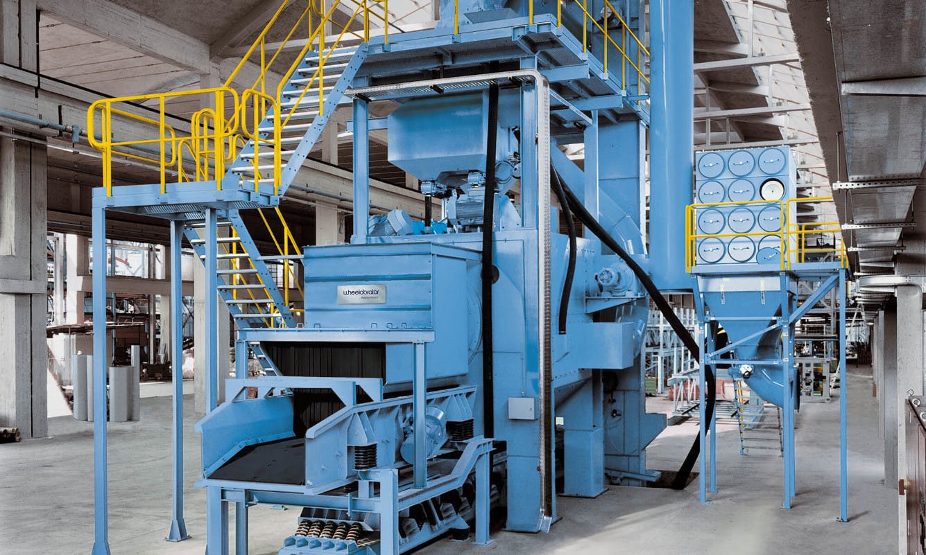

Intat’s choice for a new blasting process was the Wheelabrator CT3 machine, part of the Continuous Tumblast series of continuous through-feed shot blasting systems for automatic, high-volume parts cleaning.
In contrast to batch tumblers that are loaded and unloaded for each cleaning cycle, the CT3 continuously tumbles parts through the machine on an apron conveyor. It integrates well into the existing operation, and the conveyor tumbles the parts to ensure every surface is exposed to blast wheels for thorough cleaning. It adjusts throughput speed and abrasive flow automatically to manage with varying workloads and mixed runs, maximizing throughput.

The installation was completed midway through 2024, and now the single Wheelabrator machine is effectively handling Intat Precision production rate of at least 240 cored/300 uncored castings per hour in service to two Disamatic lines. There’s no more shuttling or strenuous manual part separation to segregate products for different machines, and the CT3’s higher surface-quality results have meant that there is no more “reblasting” of parts.
The CT3 is also a dust-free operation, so there is no airborne silica from the new machine, and the new machine’s compact footprint suits the foundry’s layout.
